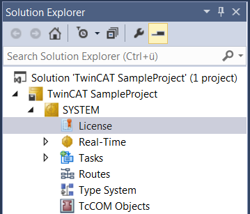

- 4. In the Solution Explorer, double-click License in the SYSTEM subtree.
- The TwinCAT 3 license manager opens.

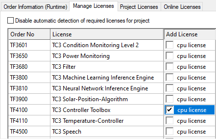

- 5. Open the Manage Licenses tab. In the Add License column, check the check box for the license you want to add to your project (e.g. "TF4100 TC3 Controller Toolbox").

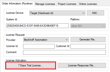

- 6. Open the Order Information (Runtime) tab.
- In the tabular overview of licenses, the previously selected license is displayed with the status “missing”.
- 7. Click 7-Day Trial License... to activate the 7-day trial license.

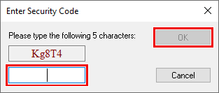

- A dialog box opens, prompting you to enter the security code displayed in the dialog.
- 8. Enter the code exactly as it is displayed and confirm the entry.
