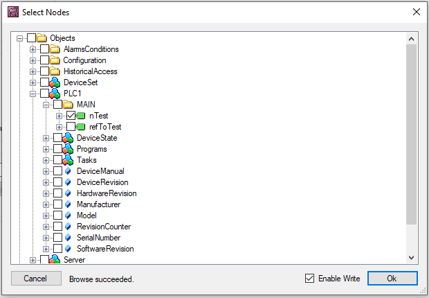

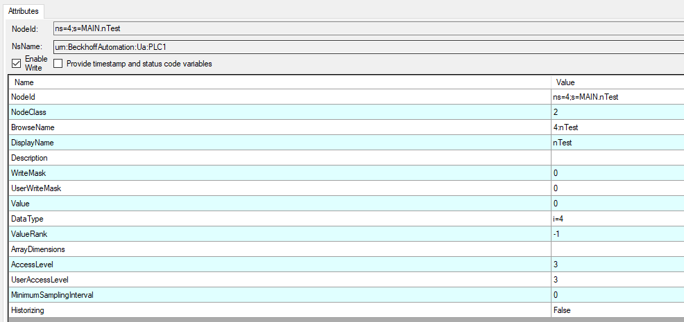

  1. The flag "Enable Write" must be set for the variable. This can be done either during the adding process via the button Add Nodes or afterwards in the parameter settings of the variable.

In order to add not only an input (Read) element but also an output (Write) element for a variable in the process image, it must be enabled explicitly. This can be done by using the Add Nodes dialog while adding the variables, for example:
Writing variables 1:
Alternatively, this setting can be enabled/disabled at a later stage via the configuration parameters of the variables in the process image.
Writing variables 2:

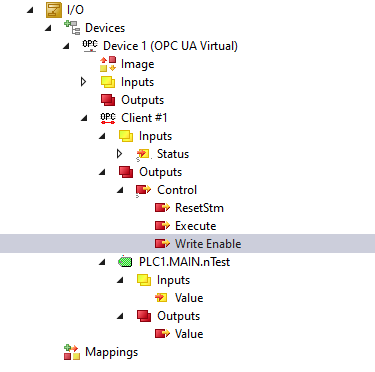

Enabling write access globally
Before write commands can be sent, they must be enabled globally. This is done by setting the output variable "Write Enable" for the I/O client:
Writing variables 3:
