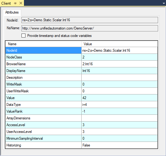

Timestamp and StatusCode
If you double-click on a node in the process image, you will see the UA attributes with their current values as they were at the time of opening the window.
Timestamp and StatusCode 1:
Further variables that can be used for diagnostic purposes are added to the process image using the check box Provide timestamp and status code variables.
Timestamp and StatusCode 2:
