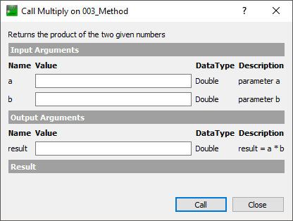

Example: Method on server
Method calls 1:

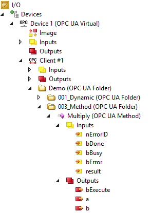

Example: Method after addition to the process image
Method calls 2:

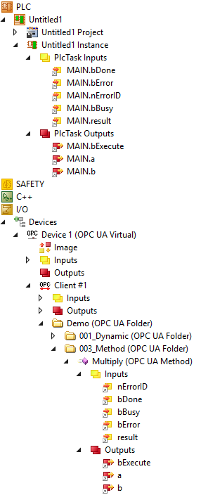

You can then create a mapping between the input/output variables and the PLC variables.
Method calls 3:

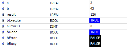

Calling of a method
To call a method, set the output variable bExecute to TRUE. You can check whether the method call has been completed and whether it was successful via the input variables nErrorID, bDone, bBusy and bError.
