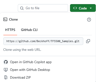

Sample code and configurations for the individual product areas can be obtained from the corresponding repository on GitHub (see links below).
For example, you have the option to clone the repository or to download a ZIP file containing the sample by clicking on Download ZIP.
