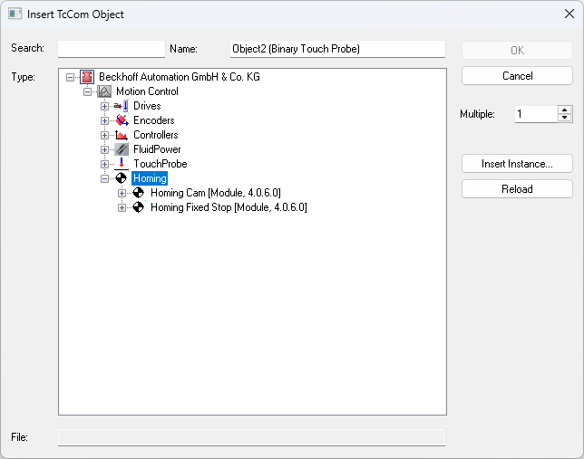

Add homing module
- 1. In the MC project, right-click on Axes > Axis > Add New Item…
in the structure tree.
- 2. In the Insert TcCOM Object dialog box, navigate to the Homing group under Type and the Motion Control group.
- 3. Expand this group if necessary.
- 4. Select the appropriate homing module and complete the process by clicking the OK button.
Be sure to select the same module version as the one used for existing Motion Control objects in the Solution.

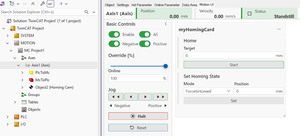

Start the homing procedure
The sequence configured in the homing module can be started in the PLC using the MC_Home function block. Alternatively, this can also be done using Home Control within a Motion UI card.
