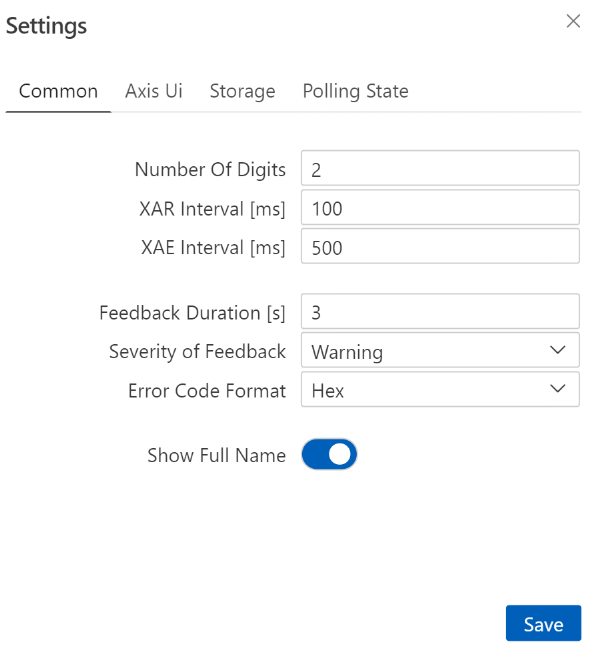

Settings
Under “Settings”, you can configure various settings for the Motion UI. Clicking Save saves the settings you have configured within the project.
Setting options 4:
Common
Selection
Number Of Digits
Number of decimal places to display.
XAR Interval [ms]
Specifies the interval at which data is read from the runtime environment.
XAE Interval [ms]
Specifies the interval at which data is read from the engineering environment.
Feedback Duration [s]
Sets the duration for which the feedback window (pop-up) is displayed.
Severity of Feedback
Specifies from which level events are displayed in the feedback window.
Error Code Format
Options: Hex, Decimal
Specifies the format in which the error code is displayed (as a hexadecimal or decimal number).
Show Full Name
If necessary, enlarges the axis name display so that it is shown in its entirety.
Lock Layout
If selected, this prevents cards from being accidentally moved or resized. Everything continues to work as usual, only the layout is fixed.
Axis UI
Selection
Allow PLC Override
This option is disabled by default. In that case, axis limits and overrides cannot be changed in the UI as long as the axis is controlled by the PLC. If this option is enabled, the user can override the axis enable settings and the override in the user interface.
Allow Keyboard Control
This option is disabled by default. In that case, axes cannot be moved using the keyboard.
If this option is enabled, you can jog the axes using the arrow keys. Pressing the spacebar stops the axis.
