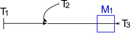

Track networks and collision avoidance 7:
In this example, mover 1 is on track 1 within the Collision Range, so mover 1 blocks the movement of mover 2 to track 3. Mover 2 stops exactly at the start of the Collision Range of track 2, as this is the last safe stopping point. If the gap between mover 1 and mover 2 would allow it, mover 2 would move to a correspondingly later stop.

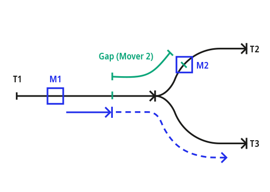

Track networks and collision avoidance 10:
In this example, mover 2 is closer to the switch than Gap, so mover 1 cannot move to track 3. Mover 1 is thus blocked on its way to track 3 on track 1 and stops as long as mover 2 is not moved any further away from the switch. If mover 2 is moved so that its Gap no longer includes the node, mover 1 can reach its destination on track 3. If the Gap is reduced by mover 2, mover 1 can continue (possibly even to its destination on track 3).
