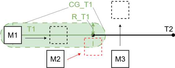

Collision avoidance between Planar movers and Planar tracks 1:
M1, M2, M3
Mover 1, Mover 2, Mover 3
R_T1
max. radius
CG_T1
Collision geometry
T1, T2
Track 1, Track 2
In this example, Planar mover 1 (M1) moves on Planar track 1 (T1). As a result, Planar track 1 is in Moving operation mode and blocks its collision geometry (in green). This results from all points that have a distance to the Planar track 1 that is less than (or equal to) the maximum radius (R_T1). The MoveToPosition command of Planar mover 2 (M2) is therefore rejected, as its target position collides with the collision geometry of Planar track 1. The MoveToPosition command of Planar mover 3 (M3) is not rejected because its target position and movement do not collide with the collision geometry of Planar track 1 and Planar track 2 does not block its collision geometry in the Standing operation mode. During the movement of the Planar mover 3, no mover can now perform a movement on the Planar track 2. This would be rejected with a collision with Planar mover 3.
