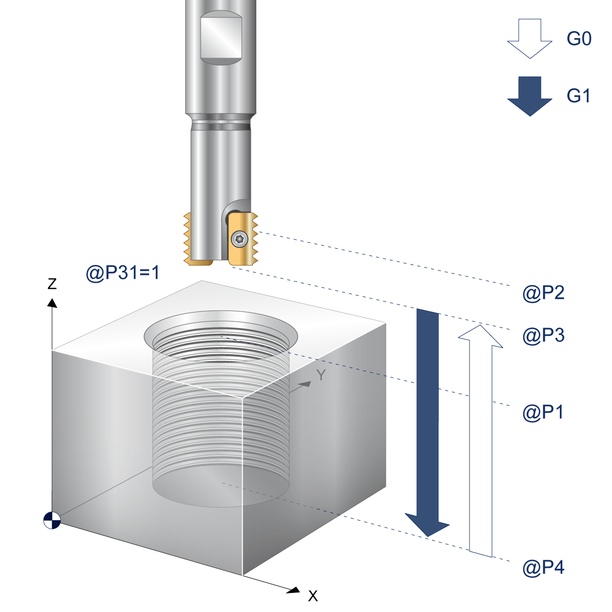

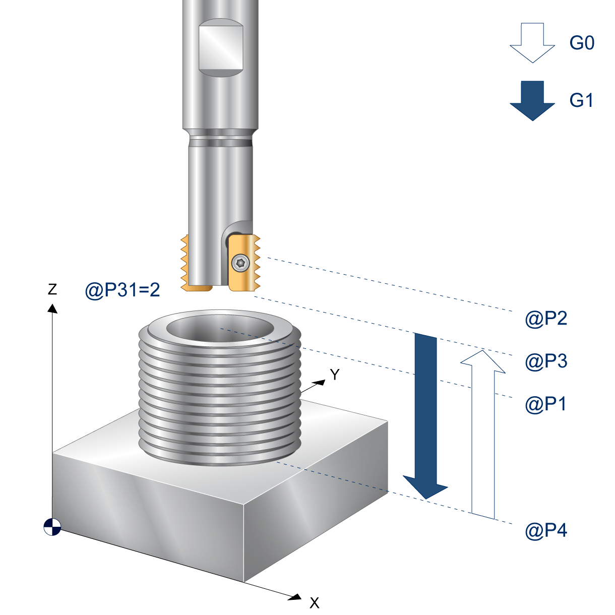

@P1
Reference plane (absolute)
@P2
Retraction plane (absolute)
@P3
Safety clearance (relative to the reference plane, unsigned)
@P4
Depth in Z axis (relative to reference plane, unsigned)
@P7
Thread pitch (unsigned)
@P68
Nominal thread diameter

@P37
Machining mode:
1: inner (default value)
2: outer

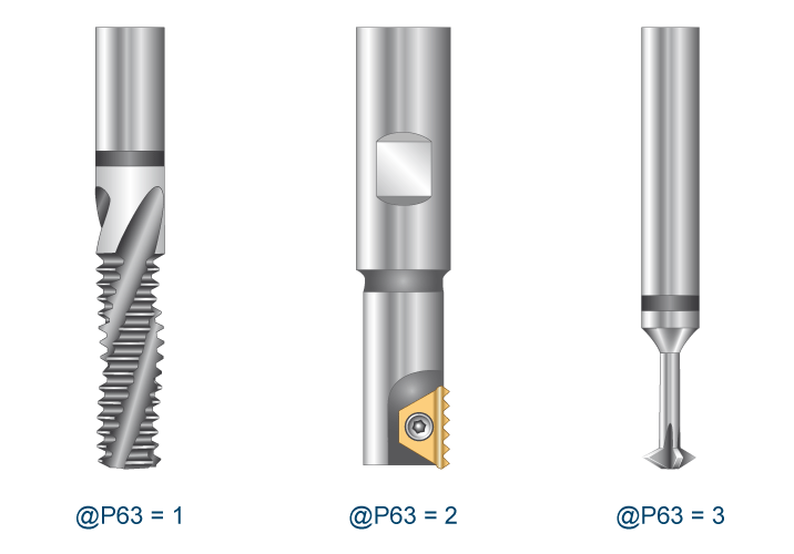

@P63
Tool type
1: full profile thread milling cutter (default value)
2: indexable insert thread milling cutter
3: Single-flute thread milling cutter

Machining modes:
Parameterisation 1:
Parameter for inner machining mode
Parameterisation 2:
Parameter for outer machining mode
Tool types
Parameterisation 3:
Thread milling cutter types
