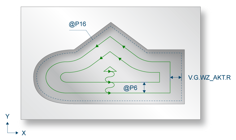

The function of the parameters acting in the XY plane is derived largely from the graphic below:
It is recommended to use the Syntax check to verify whether the input parameters are correctly assigned.
Parameterisation 1:
SysMillContourPocket - 2D view

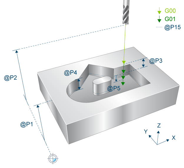

Parameters which mainly refer to the Z axis are displayed in the graphic below:
Parameterisation 2:
SysMillContourPocket - 3D view
