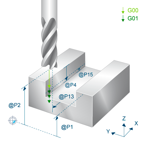

The function of the parameters acting in the XY plane is derived largely from the graphic below:
It is recommended to use the Syntax check.to verify whether the input parameters are correctly assigned.
Parameterisation 1:
Top view - open slot
Parameters which mainly refer to the Z axis are displayed in the graphic below:
Parameterisation 2:
3D view - open slot
