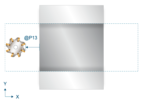

At the start, the start point in the XY plane is approached at the height of the retraction plane. At this start point, the milling cutter has the safety clearance to the blank as set in @P13. The starting point lies in the direction of the negative X axis relative to the reference point (at orientation angle 0).
After executing the cycle, the milling cutter retracts to its position when the cycle was called.
The slot must be approachable without collision along its opening with the clearance [2*V.G.WZ_AKT.R+@P13]. The dashed area in the graphic below is travelled during the cycle at machining height.
