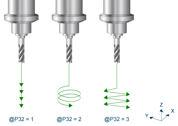

At the start of roughing, the starting point in the XY plane is approached for each slot at the height of the retraction plane. First, the infeed moves to the safety plane at rapid traverse along the Z axis followed by a vertical (@P32=1) or helical (@P32=2) or oscillating (@P32=3) infeed to the machining height at the feedrate.
The beginning of the slot is started with the oscillating infeed. When the required infeed depth is reached, the milling cutter is positioned at the centre of the slot. At this start point, an iterative feed takes place up to the new machining height at the feedrate defined in @P21 until the slot depth @P4 is reached with the addition of the finishing allowance at the base (@P15). The maximum feed in Z per pass is the maximum feed in Z at the maximum value defined in @P5.

The start point mentioned for roughing is also approached as the starting position for finishing. From there, an interative feed takes place up to the new machining height until the slot depth is reached. The maximum infeed per pass is the maximum infeed in Z at the maximum value defined in @P5.
A distinction is made between two cases for the milling operation at each machining height:
- If no finishing allowance at the base needs to be removed at the current machining height, only the finishing allowance at the edge of the slot is removed. Infeed is vertical.
- If the current machining height also involves a removal of the finishing allowance at the base, the complete circumferential slot must be again machined at this height until the correct dimensions are reached. Infeed in Z is vertical (@P32=1) or helical (@P32=2) or oscillating (@P32=3).
