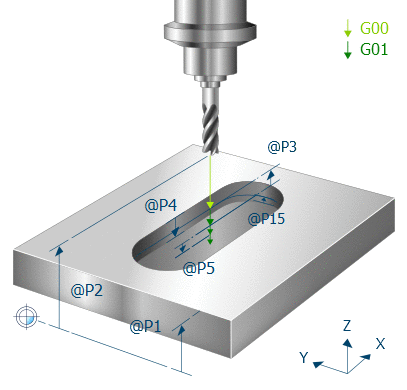

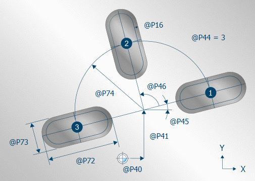

The function of the parameters acting in the XY plane is derived largely from the graphic below:
It is recommended to use the Syntax check to verify whether the input parameters are correctly assigned.
Parameterisation 1:
Top view – slots arranged in a circle
Parameters which mainly refer to the Z axis are displayed in the graphic below:

3D view – slots arranged in a circle
