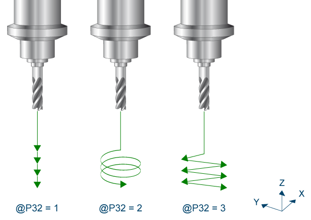

At the start of roughing, the start point for every slot is approached via the centre of the slot in the XY plane at the height of the retraction plane. The infeed is first to the safety plane at rapid traverse along the Z axis followed by a vertical (@P32=1) or helical (@P32=2) or oscillating (@P32=3) infeed to the machining height at the feedrate.
The beginning of the slot is started with the oscillating infeed. When the required infeed depth is reached, the milling cutter is positioned at the centre of the slot. At this start point, an iterative feed takes place up to the new machining height at the feedrate defined in @P21 until the slot depth @P4 is reached with the addition of the finishing allowance at the base (@P15). The maximum feed in Z per pass is the maximum feed in Z at the maximum value defined in @P5.

- If the current machining height also involves a removal of the finishing allowance at the base, the complete slot must be again machined at this height until the correct dimensions are reached. Infeed in Z is vertical (@P32=1) or helical (@P32=2) or oscillating (@P32=3).
