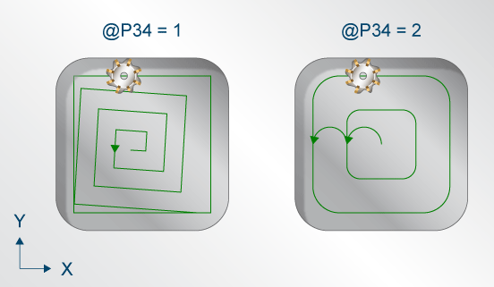

At every machining height, the pocket is again milled from the centre outwards in a helical movement (@P34=1) or incrementally at infeed in a semicircle (@P34=2). The clearance of the paths between one pass around never exceeds the maximum value of the maximum feed in XY defined in @P5.
