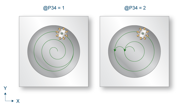

At every machining height, the circular pocket is again milled from the centre outwards in a helical (@P34=1) or circular movement at infeed in a semicircle (@P34=2). The radius is obtained from the pocket radius (@P68) minus the finishing allowance at the edge (@P16). The clearance of the helical or circular path between each circumferential pass never exceeds the value of the maximum infeed in XY defined in @P6.
