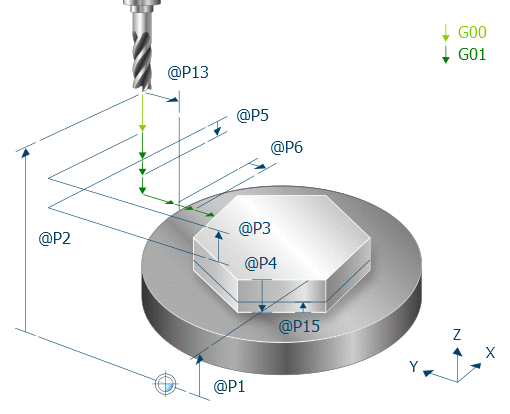

The function of the parameters acting in the XY plane results from the graphic below:
It is recommended to use the Syntax check to verify whether the input parameters are correctly assigned.
Parameterisation 1:
Top view - multi-edge
The majority of parameters which mainly refer to the Z axis are displayed in the graphic below:
Parameterisation 2:
3D view - multi-edge
