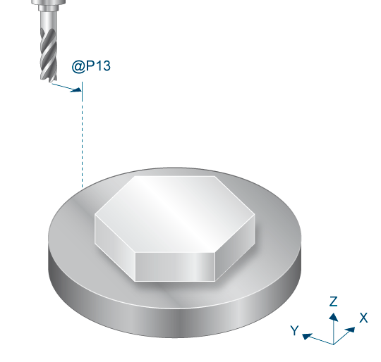

Within the cycle, the tool is fed incrementally along the Z axis. The starting point here is a start point which has a safety clearance to the blank set by @P13 in the XY plane and is vertically parallel to the Y axis under the spigot centre. The blank is approached in a circular or linear movement along the outer edge for each machining height. When the machining direction is clockwise (@P30=0 -> down milling), the approach is counter-clockwise and retraction is clockwise. When the machining direction is counter-clockwise (@P30=1 -> up milling), the approach is clockwise and retraction is counter-clockwise.
The milling operation has a helical shape for a multi-edge which has more than two edges. The milling operation has a linear shape for a multi-edge with one or two edges. The blank is continuously circled in the direction set in @P30 during the milling operation.

To permit a circular approach to the blank, it must be possible to circle the blank safely at machining height at a clearance D = [@P13 + 2 * tool radius]. The green dashed line in the graphic below describes the area in which no collision may occur.
