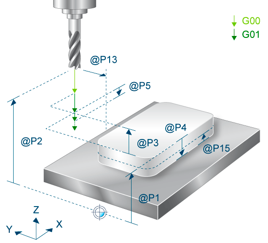

Required input parameters
Input parameters
@P1
Reference plane (absolute)
@P2
Retraction plane (absolute)
@P3
Safety clearance in Z (relative to reference plane/machining height)
@P4
Depth (relative to reference plane)
@P5
Maximum infeed in Z
@P6
Maximum infeed in XY (maximum 2*V.G.WZ_AKT.R)
@P69
Length of blank
@P70
Width of blank
@P72
Length of spigot
@P73
Width of spigot

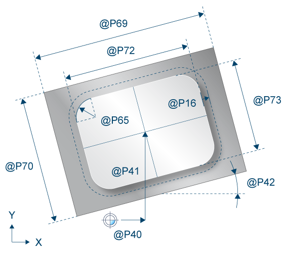

Optional input parameters
Input parameters
@P13
Safety clearance to blank in the XY plane (relative)
Default value is the tool radius
@P15
Finishing allowance at base
Default value = 0
@P16
Finishing allowance at edge
Default value = 0
@P20
Feed rate for milling operation (specified in mm/min, inch/min)
@P21
Feed rate in Z (values in mm/min, inch/min)
@P22
Feed rate for finishing for milling in the XY plane (specified in mm/min, inch/min)
The default value is the feed rate for roughing
@P23
Feed rate for finishing in Z (specified in mm/min, inch/min)
The default value is the feed rate for finishing for milling in the XY plane
@P25
Spindle speed for finishing (specified in rpm)
Default is the spindle speed at cycle call
@P30
Machining direction
"ClimbMilling" or 0: Down milling (default)
"UpCutMilling" or 1: Up milling
@P31
Machining mode:
"Roughing" or 1: Roughing
"Finishing" or 2: Finishing
"Roughing+Finishing" or 3: Roughing and finishing (default value)
@P40
Position of centre in X
Default value is the current position
@P41
Position of centre in Y
@P42
Angle of inclination of pocket (in degrees)
Default value = 0
@P65
Corner radius of spigot
Default value = 0
@P135
Maximum infeed in XY for edge finishing
Default value is the maximum infeed in XY for roughing
@P170
Maximum infeed in XY for base finishing
@P171
Feed rate for plunging in previously milled areas
Default value is the feed rate for roughing for the infeed in Z
The function of the parameters acting in the XY plane results from the graphic below:
It is recommended to use the Syntax check to verify whether the input parameters are correctly assigned.
Parameterisation 1:
Top view - rectangular spigot
Parameters which mainly refer to the Z axis are displayed in the graphic below:
Parameterisation 2:
3D view - rectangular spigot
