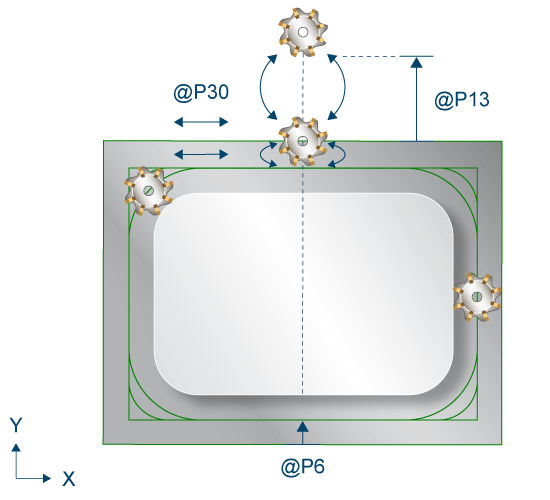

Within the cycle, the tool is fed incrementally along the Z axis. The starting point here is a start point which has a safety clearance to the blank set by @P13 in the XY plane and is vertically parallel to the Y axis above the spigot centre. The blank is repeatedly approached in a circular movement for each machining height. With a clockwise machining direction (@P30=0), approach is counter-clockwise and departure is clockwise. With a counter-clockwise machining direction (@P30=1), approach is clockwise and departure is counter-clockwise.

At the start, the start point in the XY plane is approached at the height of the retraction plane. The first feed is to the safety plane at rapid traverse along the Z axis followed by a feed to the machining height at the feed rate defined by @P21. Starting at this start point, an iterative feed takes place at the new machining height until the spigot depth @P4 is reached with the addition of the finishing allowance at the base (@P15). The maximum infeed per pass is the maximum infeed in Z at the maximum value defined in @P5.
The blank is first milled linearly for every machining height, i.e. without considering the corner radius (@P65). The tool then approaches closer to the centre of the spigot in a circular movement each circumferential pass without exceeding the maximum feed in XY (@P6). Linear removal continues until the linear outer dimensions of the spigot (@P72 and @P73) with the addition of the finishing allowance at the edge (@P16) are removed.
When linear machining is completed, the corner radius is milled (@P65). Corner removal continues every circumferential pass around the spigot until the correct radius (corner radius + finishing allowance in XY) is reached.
