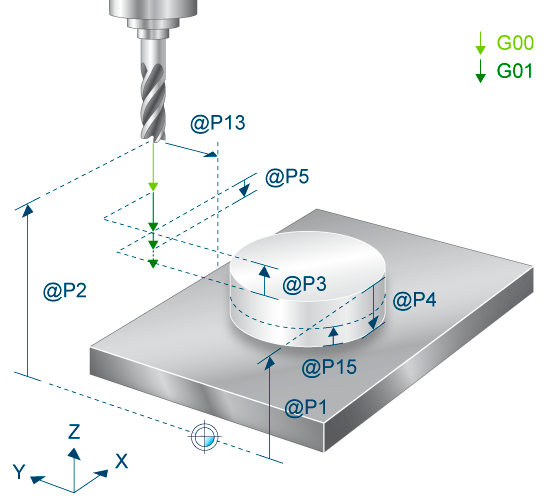

Parameterisation
Required input parameters
Input parameters
@P1
Reference plane (absolute)
@P2
Retraction plane (absolute)
@P3
Safety clearance in Z (relative to reference plane/machining height)
@P4
Depth (relative to reference plane)
@P5
Maximum infeed in Z
@P6
Maximum infeed in XY (maximum 2*V.G.WZ_AKT.R)
@P68
Diameter of spigot
@P69
Length of blank (X axis)
@P70
Width of blank (Y axis)

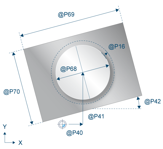

@P42
Angle of inclination of blank (in degrees)
Default value = 0

The function of the parameters acting in the XY plane results from the graphic below:
It is recommended to use the Syntax check to verify whether the input parameters are correctly assigned.
Parameterisation 1:
Top view - circular spigot
Parameters which mainly refer to the Z axis are displayed in the graphic below:
Parameterisation 2:
3D view - circular spigot
