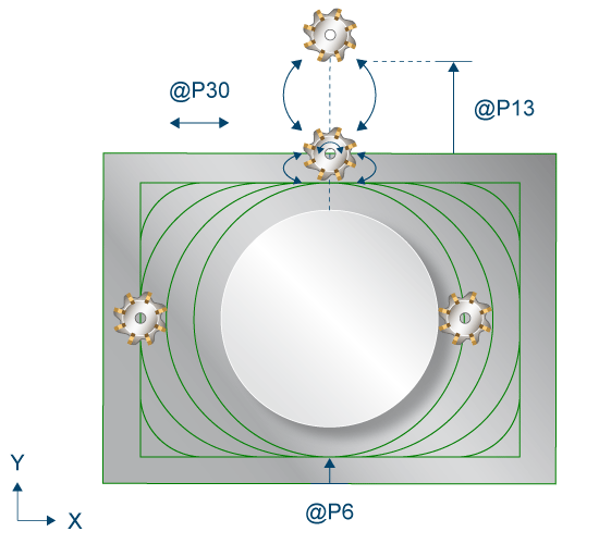

Within the cycle, the tool is fed incrementally along the Z axis. The starting point here is a start point which has a safety clearance to the blank set by @P13 in the XY plane and is vertically parallel to the Y axis above the spigot centre. The blank is repeatedly approached in a circular movement for each machining height. When the machining direction is clockwise, the approach is counter-clockwise and departure is clockwise. When the machining direction is counter-clockwise, the approach is clockwise and departure is counter-clockwise.

The blank is first milled linearly for every machining height, i.e. without considering the spigot diameter (@P68). The tool then approaches closer to the centre of the spigot in a circular movement each circumferential pass without exceeding the maximum feed in XY (@P6). Linear removal continues until the linear outer dimensions of the circle with the addition of the finishing allowance at the edge (@P16) are removed.
When linear machining is completed, the spigot diameter is milled (@P68). Corner removal continues every circumferential pass around the spigot until the correct diameter (spigot diameter + finishing allowance in XY) is reached.
