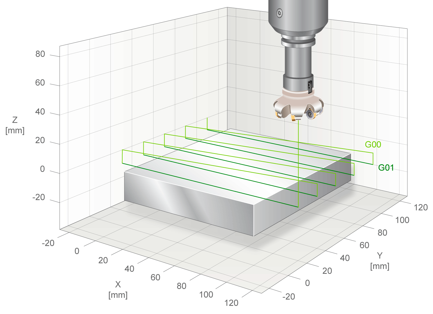

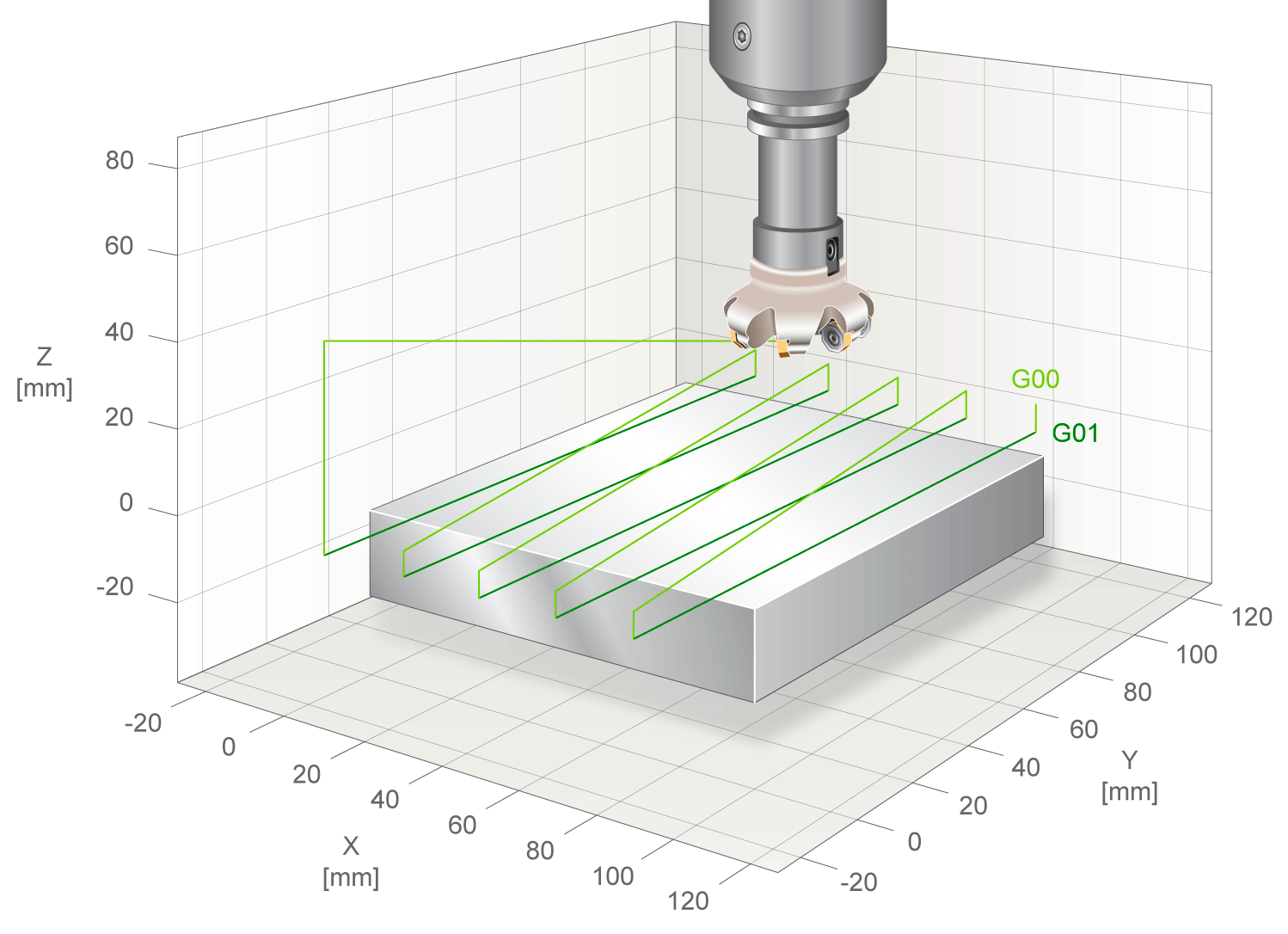

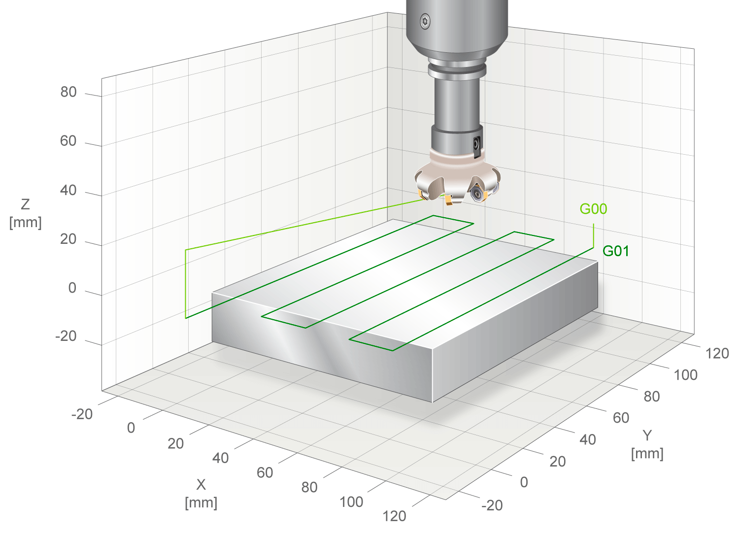

Machining directions 1-6
Parameterisation 1:
Machining direction parameter 1 of 6
Parameterisation 2:
Machining direction parameter 2 of 6
Parameterisation 3:
Machining direction parameter 3 of 6
Parameterisation 4:
Machining direction parameter 4 of 6
Parameterisation 5:
Machining direction parameter 5 of 6
Parameterisation 6:
Machining direction parameter 6 of 6
No.
Machining direction
1
From left to right
Feed always takes place on the left-hand side outside the workpiece in the Z direction and machining is always to the right.
2
From right to left
Feed always takes place on the right-hand side outside the workpiece in the Z direction and machining is always to the left.
3
From front to rear
Feed always takes place in front of the workpiece in the Z direction and machining is always to the rear.
4
From rear to front
Feed always takes place behind the workpiece in the Z direction and machining is always to the front.
5
Alternating left and right
Feed takes place from the front left outside the workpiece in the Z direction. Machining is to the right until the tool diameter passes over the workpiece edge. The surface is then machined in zig-zag.
6
Alternating front to rear
Feed takes place from the front left outside the workpiece in the Z direction. Machining is to the rear until the tool diameter passes over the workpiece edge. The surface is then machined in zig-zag.
