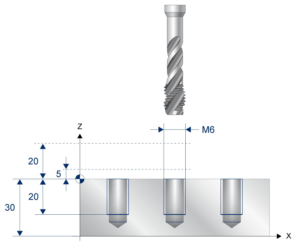

Programming example
Programming Example
Thread tapping
#VAR
  ; input parameters:
  V.L.SurfacePosition         = 0   (Z position of workpiece surface )
  V.L.RetractionPlane         = 20  (Z position of retraction plane )
  V.L.SafetyClearance         = 5   (rel. value of safety clear. in Z )
  V.L.DrillingDepth           = 20  (depth )
  V.L.ThreadPitch             = 1   (pitch of the thread )
  V.L.SpindleSpeed            = 200 (spindle rotation speed )
  V.L.NumberOfFeeds           = 2   (number of feeds )
  V.L.DwellTime               = 2   (dwell time )
  V.L.ThreadType              = -1  (thread type (default = 1))
  V.L.MachiningMode           = 1   (machining mode )
  V.L.ReturnClearance         = 3   (return clear. chip breaking/evac.)
  V.L.SpindlePositioningMode  = 0   (angle of pos. (default = 0) )

Programming example 1:
Programming example: Drill tapping process
