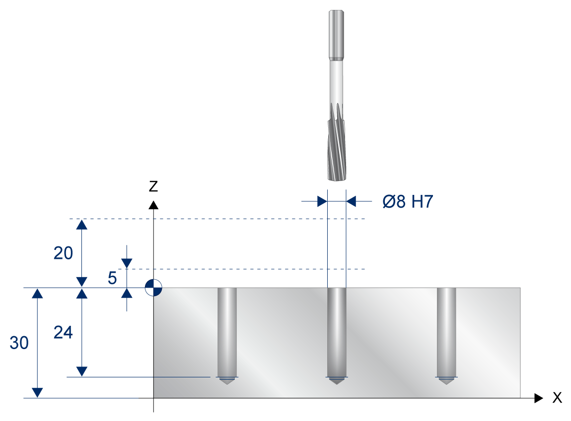

Reaming
#VAR
  ; input parameters:
  V.L.SurfacePosition = 0   ( Z position of workpiece surface )
  V.L.RetractionPlane = 20  ( Z position of retraction plane )
  V.L.SafetyClearance = 5   ( relative value of safety clearance in Z )
  V.L.DrillingDepth   = 24   ( depth )
  V.L.RetractMode     = 0    ( retract mode (default = 1) )
#ENDVAR
T7 D7                        ( tool data )
M6                           ( tool change )
G17 G90 G54 F50 M03 S350     ( technology data )
G00 Z100                     ( go to z start position )
G00 Y20 X0                   ( 1st position retract G01 (default) )
L CYCLE [NAME=SysDrillReaming.ecy   \
    @P1 = V.L.SurfacePosition       \
    @P2 = V.L.RetractionPlane       \
    @P3 = V.L.SafetyClearance       \
    @P4 = V.L.DrillingDepth         \
G00 X40 Y20                  ( 2nd position retract G00 )
    @P92 = V.L.RetractMode          \
G00 Z200 M5                  ( Final position, stop of spindle )
M30
Programming example 1:
Programming example: Reaming process
