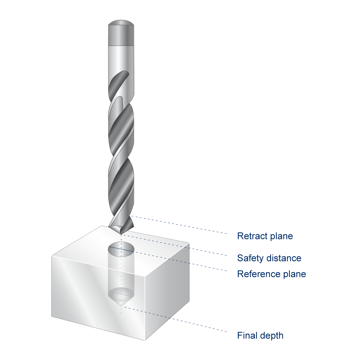

Geometry and machining data
When cycles are called, a distinction can be made between:
Geometry and machining data assign input parameters for each cycle.
Geometry parameters include data to define the:
Geometry and machining data 1:
General geometry parameters
Machining parameters have a specific meaning and effect. They are described in detail in each of the cycles. They mainly include technological information such as dwell times, number of feeds, rotation directions etc., in fact all the data required in the machining process.
