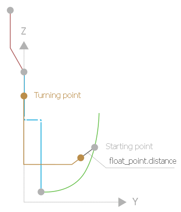

Flushing process end point, floating point
The floating point defines the end point of the flushing process. It is commanded as the distance from the original starting point of the flushing process. After the inversion point is reached, the electrode continues to move forwards up to the floating point. The distance to go to the original starting point must be traversed at the external velocity commanded by the PLC.
Flushing process end point, floating point 1:
Position of the end point of flushing
