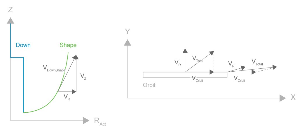

In the orbiting function, the resulting electrode motion is obtained from superposition of the three channels. The dynamics of the individual channels must be limited in these phases so that superposition does not result in a violation of axis dynamics. Since only the down or escape channel may move the electrode during erosion on the path, a weighting is not necessary in this phase.
The figure below shows the radial, tangential and total velocity vectors at sample points in the orbit and down channels.
The following applies to the path velocity vector in the down channel:
The same applies to the path velocity vector in the orbit channel:
Since the two channels are superimposed, the total velocity is therefore:
Due to the dynamic limitations of the machine, the following applies:
and
For the maximum total velocity
the two cases shown on the right in the above figure are the result:
However, it is advisable to limit the maximum dynamic range of each channel to half of its maximum value to ensure that the maximum dynamic range is not exceeded at any time.
