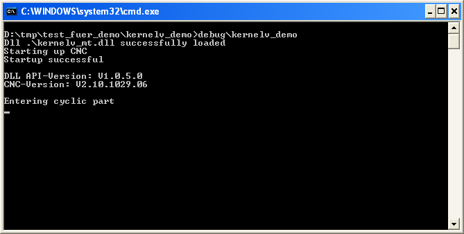

Start screen
After start, the screen below is displayed:
Use of the demo application 1:
The start screen of the demo application

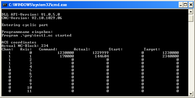

The screen below appears after the supplied test program is executed and the axis positions are displayed:
Use of the demo application 2:
Display axis positions in demo application
