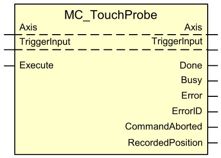

Block diagram of the function block in PLCopen:
Input pin
Unit
