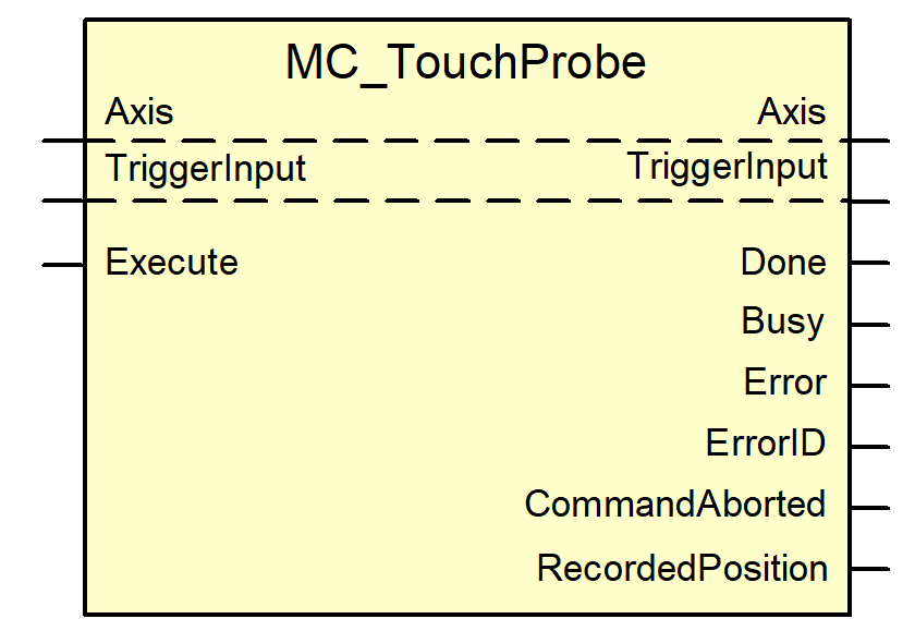

MC_TouchProbe
The MC_TouchProbe FB records an axis position when a trigger event occurs. The measurement channel and method (rising or falling edge of the trigger signal) are defined via the reference for the trigger signal source.
Blockdiagramm
Parameters of the FB
