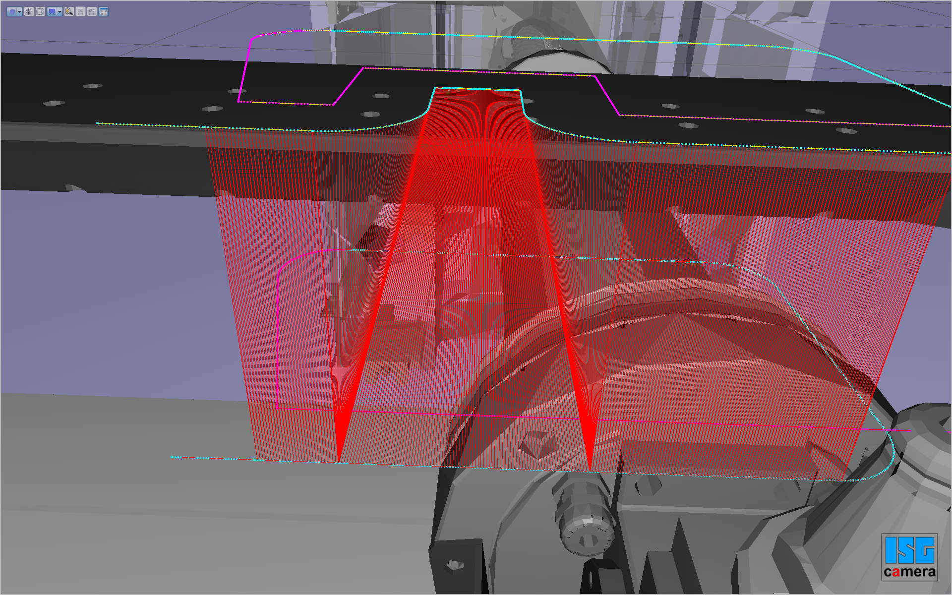

Without taper link function at the outer corner
Description 4:

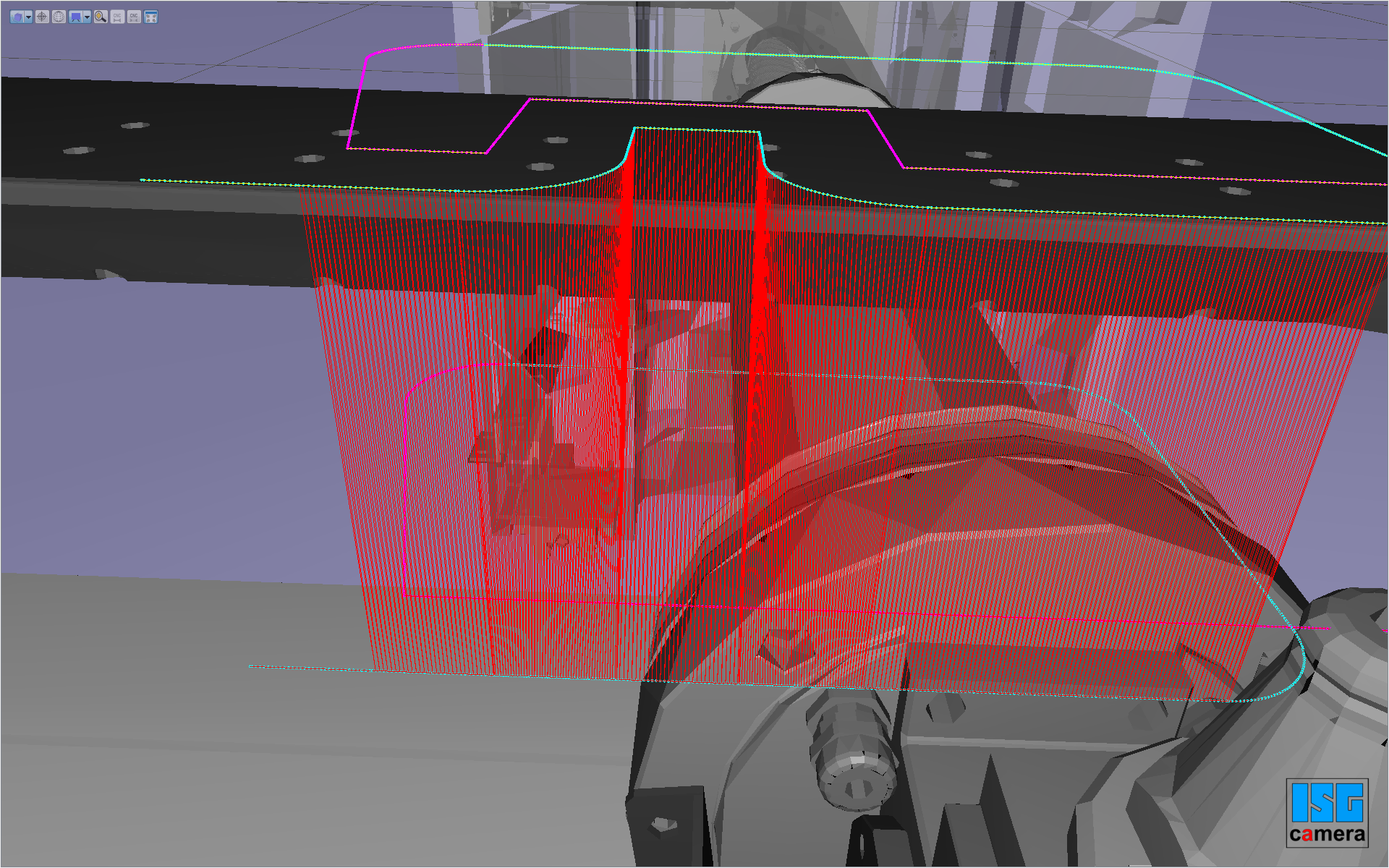

Active taper link function at outer corner
The taper link functionality is shown by means of a simple geometry (inactive/active):
Description 5:
Simple example without taper link functionality
Description 6:
Simple example with active taper link functionality
