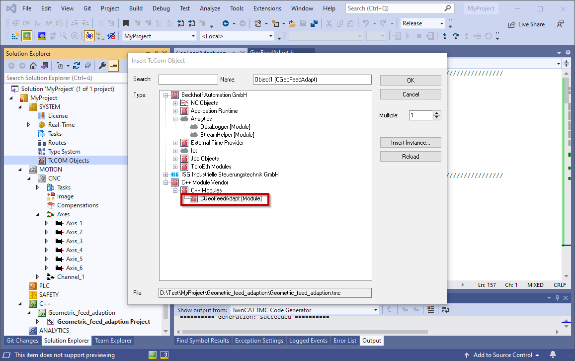

Integrate geometric feed adaptation object
After the geometric feed adaptation object is created, it must be integrated into the existing CNC configuration as follows:
Integrate geometric feed adaptation object 1:
Integrating the TcCOM object

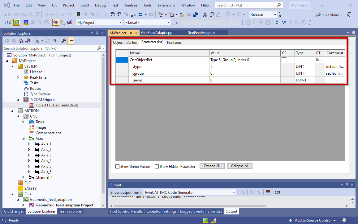

Integrate geometric feed adaptation object 2:
Properties of the TcCOM object
The type of the geometric feed adaptation object is 5.
The channel specification is dependent on whether instance-specific variables are used in the TcCOM object.
The index of each object is not used.
