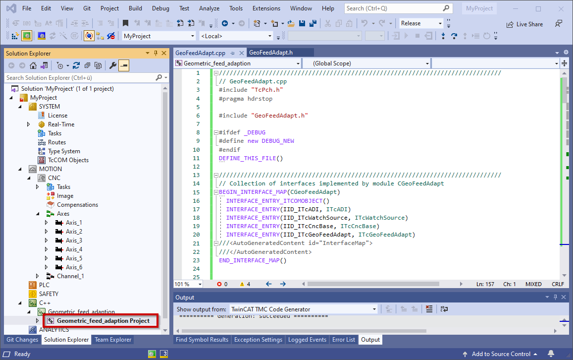

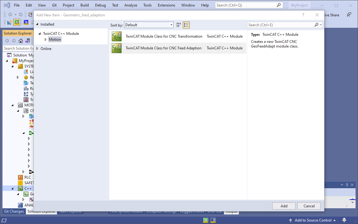

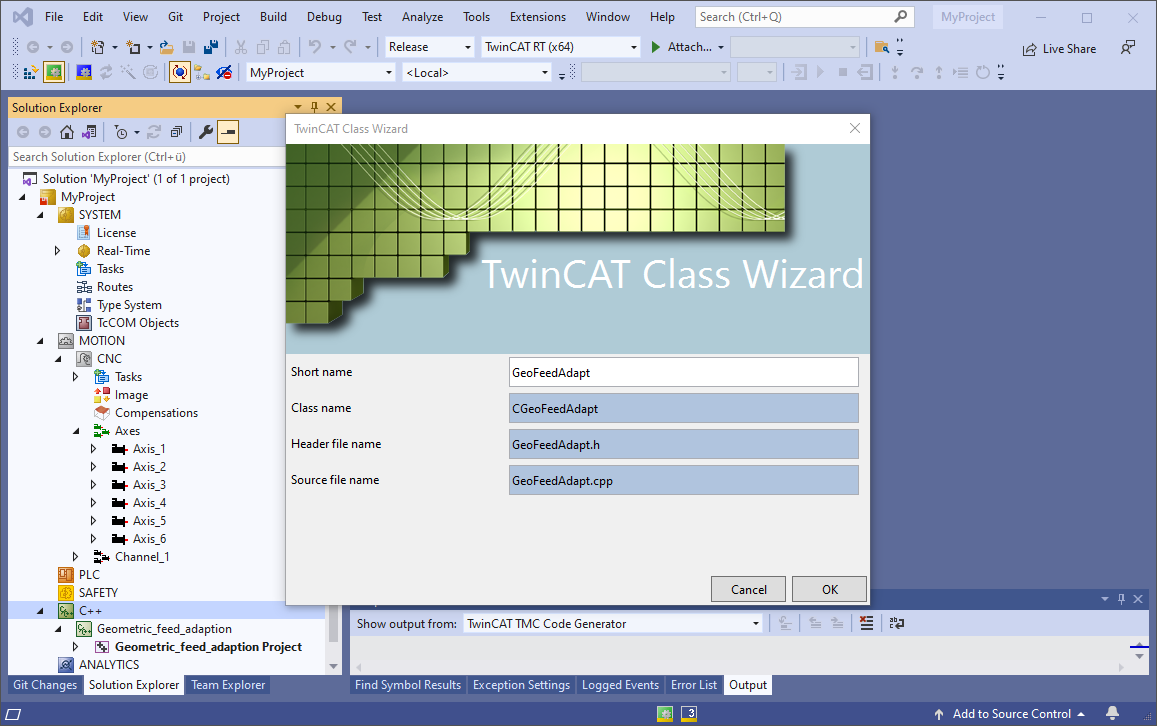

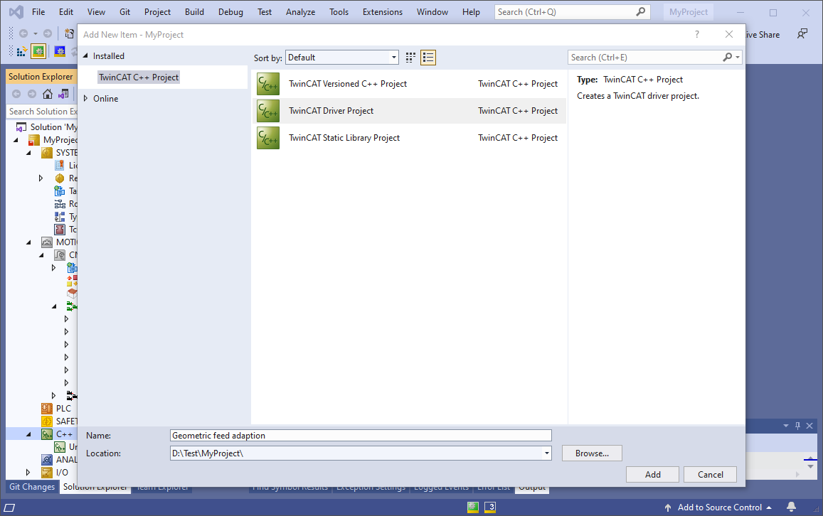

The procedure below is an example of creating a user-defined geometric feed adaptation object using Visual Studio 2019,
Right-click on the project to “Create” the driver.
