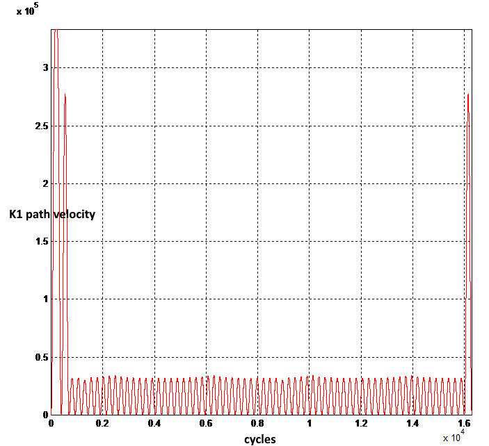

SURFACE and five-axis machining 1:
Path velocity with linear blocks and perpendicularly oriented tool
The feed rate fluctuates significantly due to the inconsistency of the rotary axis.
