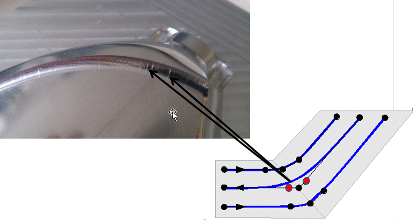

The HSC Surface Optimiser was developed to achieve consistent machining results regardless of the point distribution by the CAM system. In particular, the density of interpolation points on neighbouring machining paths can fluctuate with some CAM systems, which would lead to an uneven machining result. The figure below shows a machining result of this kind. The two points marked in red are missing on one of the neighbouring machining paths. This results in a different tool path (blue) in contrast to the neighbouring paths if the smoothing process is not optimised.
Surface machining with Surface 1:
Problems in workpiece quality due to uneven distribution caused by the CAM system.
In addition to uniform machining paths, the HSC Surface Optimiser ensures a high feed rate that is as constant as possible. Due to the necessary calculations, the use of the Surface Optimiser requires high-performance control hardware.
