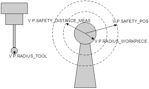

Geometry | Unit | Meaning |
V.P.RADIUS_TOOL | mm | Radius of probe tip (clamped in the spindle) |
V.P.SAFETY_POS | mm | Safety distance about the calibration sphere during pre-positioning |
V.P.SAFETY_DISTANCE_MEAS | mm | Safety distance around the calibration sphere during measurement Must be large enough to reach measurement speed. |
V.P.RADIUS_WORKPIECE | mm | Radius of the calibration sphere (placed on bench as workpiece) |
V.P.MEASURING_FEED | mm/min | Velocity for measuring (G100 blocks) |
V.P.POSITIONING_FEED | mm/min | Velocity for positioning |
V.P.KIN_TYP | - | Kinematic of the machine |
V.P.KIN_TYP_VARIANT | - | Variant of the kinematic if, for example, several kinematics can be grouped by one number, as with kinematic 90 |
#FILE NAME [MSG = "…"] | String | Path to save measurement data |
V.L.PRINT (optional) | - | Output of a log in the parameterised file, 0 = no log, 1 = German, 2 = English |
V.P.MAX_PRECISION (optional) | mm | Maximum permitted deviation of measurement errors |
V.P.LIST_FORMAT | - | Output formats: 0 = XML, 1 = TwinCAT 2, 2 = TwinCAT 3 |
The radii of the probe tip and calibration sphere only serve to calculate the motion paths and are not used to calculate offsets. It is therefore sufficient to enter approximations for these radii. The meaning of the geometry parameters is described in the figure below.
