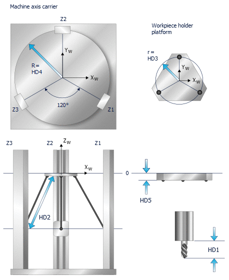

The strut kinematics consists of 3 translatory axes in a non-Cartesian arrangement and 2 Cartesian axes. 3 struts with ball joints support the workpiece platform. This may affect the Z height and orientation of the workpiece.

KIN_TYP_19 – Tripod kinematics 1:
Tripod kinematics
KIN_TYP_19 – Tripod kinematics 2:
Kinematic offsets
Offset data of kinematics
HD offset
param[i]
Unit
HD1
0
Tool offset in Z
1.0 E-4 mm
HD2
1
Strut length to joint centre point
1.0 E-4 mm
HD3
2
Radius to connecting line of joint centre points of holder platform (small circle)
1.0 E-4 mm
HD4
3
Radius to connecting line joint centre points of drive columns (large circle)
1.0 E-4 mm
HD5
4
Distance between workpiece holder platform and joint centre points on the holder platform
1.0 E-4 mm
