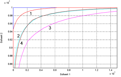

- The higher the mode (1- 3), the more sensitive vibration attenuation is compared to deviations to the set frequency (compared to the actual natural frequency of the machine). The Figure - Sensitivity ranges depicts the ranges within which the normalised frequency may lie in order to remain below 5% residual vibration (at damping = 0.1).

The figure above results in the following standard values for each of the modes regarding acceptable percentage deviations to obtain residual vibrations of below 5%:
Table of standard values for sensitivity
Permitted deviations for max. 5% residual vibration (at damping=0.1) | max. negative deviation | max. positive deviation |
Mode 1: | -3% | +3% |
Mode 2: | -13% | +19% |
Mode 3: | -20% | +33% |
Mode 4: | -10% | +13% |
Standard values for permitted percentage deviations between the frequency setting and the real frequency to obtain a residual vibration of below 5% (at damping= 0.1).
1 | Vibration Guard Mode 1 | 2 | Vibration Guard Mode 2 |
3 | Vibration Guard Mode 3 | 4 | Vibration Guard Mode 4 |
