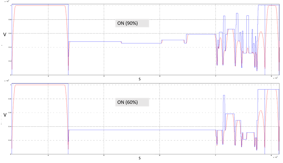

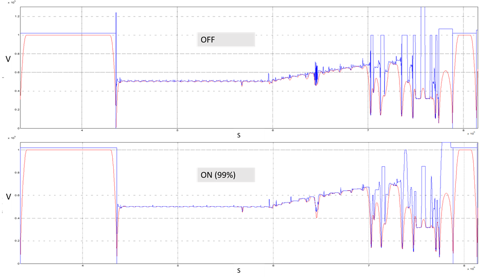

The figures below show the effect on the velocity curve with and without various productivity factors using the example of an HSC program.
Blue = Permissible maximum path velocity using the CNC object “Maximum velocity on path”.
Red = Path velocity using the CNC object “Current velocity on path”.

Effect of different productivity factors in velocity-path representation
If a productivity factor of 100 (%) is specified, the curve of the maximum blockwise path velocities will also be always adjusted or changed as well. However, this should have no influence on productivity as defined by the default of 100%.
