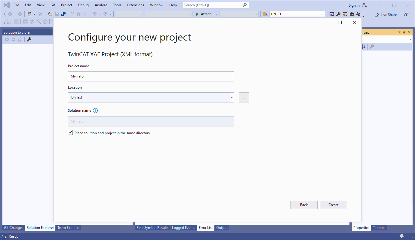

Create new project 2:
Configure the new project

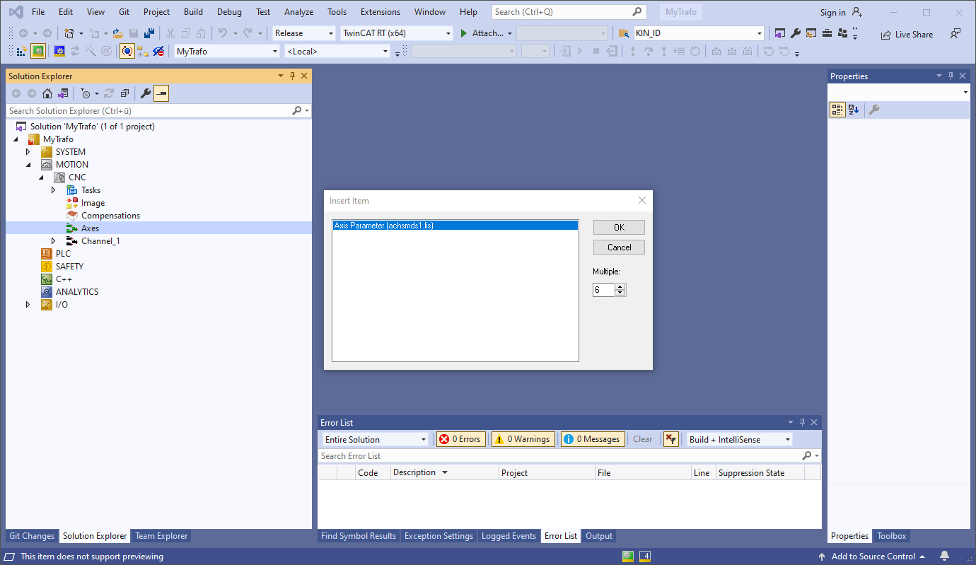

Create new project 5:
Create an axis
