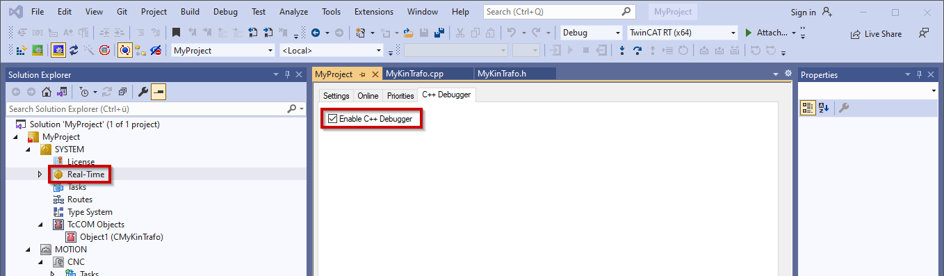

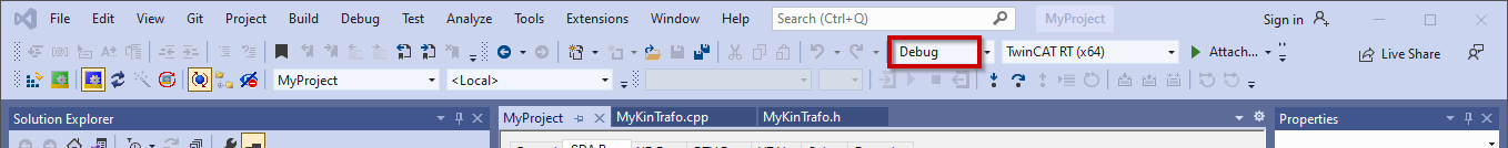

To debug, switch the transformation in the TwinCAT3 project over to debug and activate the real-time debugger.

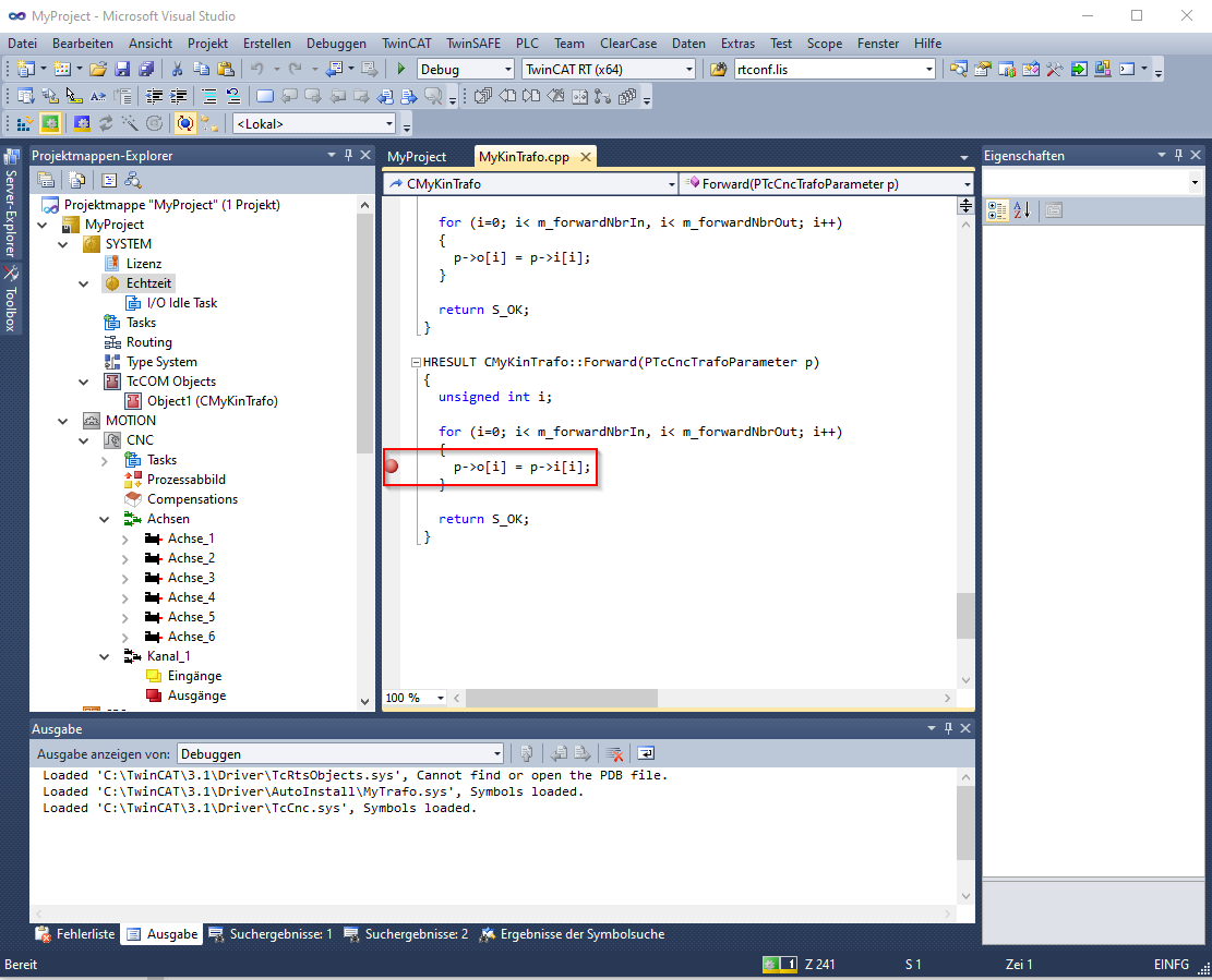

You can start debugging the transformation project after starting TwinCAT in the "RUN" state and setting the associated breakpoints.
