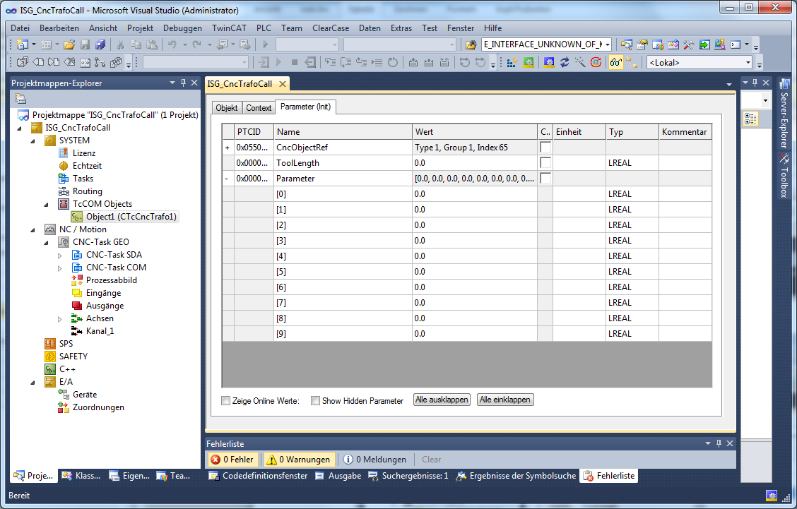

Besides the channel or tool-specific parameters, which are made available via the CNC, further individual parameters can be passed on to the transformation. These are initialised during configuration of the TcCOM object.
TcCOM parameters 1:
Transformation parameters via TcCOM

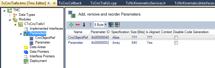

The TcCOM parameters required for the transformation can be defined in the TMC Editor:
TcCOM parameters 2:
TMC Editor
Use the TwinCAT TMC Code Generator (right-click on the TcCnCTrafo project -> TwinCAT TMC Code Generator) to automatically add the parameters in the TMC file to the class for the transformation CtcCncTrafo1 as member variables, e.g. m_Parameter. They can then be used in forward and backward transformation.
