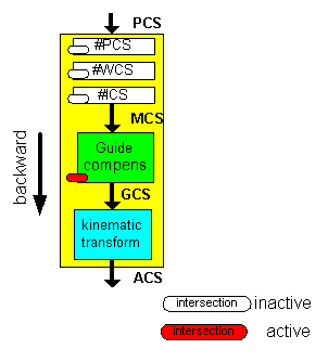

Example
Disabling intersection calculation if #CS is inactive
For example, if the kinematic transformation varies depending on whether a higher-level Cartesian transformation is active or not, you can select this operation by means of the input bit. This is indicated by the controller.
Kinematic transformation when intersection calculation is active (EcCncTrafoCtrl_cartesianTrafoInactive deleted)
Extended working data: TcNcTrafoParameterExtCnc 1:
Kinematic transformation when intersection calculation is inactive
(EcCncTrafoCtrl_cartesianTrafoInactive set)
Extended working data: TcNcTrafoParameterExtCnc 2:
