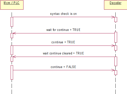

Display:
Parameter | Description |
X_SyntaxCheck | Display: Syntax check active |
X_WaitAfterError | Display: Decoder waits for enable to resume |
X_SyntaxCheckWaitContinueCleared | Display: Decoder waits for cancellation of enable to resume |
Syntax check active | |
Description | Decoder is currently in the syntax check |
Signal flow | CNC → PLC |
ST path | pMC[channel_idx]^.addr^.StateDecoder_Data.X_SyntaxCheck |
Data type | BOOL |
Value range | [TRUE = decoder operates in the syntax check, FALSE] |
Access | PLC is reading |
Special features | - |
Error occurred during syntax check – waiting for external input | |
Description | In syntax check mode, the decoder waits after an error for an external input (continue, abort) |
ST path | pMC[channel_idx]^.addr^.StateDecoder_Data.X_WaitAfterError |
Data type | BOOL |
Value range | [TRUE = error occurred in the syntax check – decoder waits, FALSE] |
Description | Decoder is currently operating in the syntax check and, after an error and enable, waits until enable is cancelled. |
ST path | pMC[channel_idx]^.addr^.StateDecoder_Data.X_SyntaxCheckReleaseNextBlockCleared |
Data type | BOOL |
Value range | [TRUE = decoder waits for enable to be cancelled, FALSE] |
