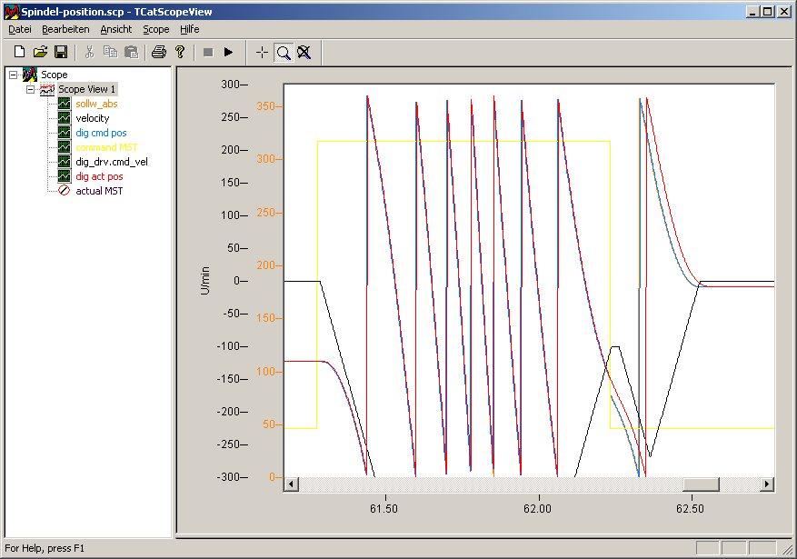

Programming Example
Effect of switch-back speed
%spindle-position
N10 M3 S1000
N20 M19 S.POS=180 M4 S50
M30
Properties 1:
Positioning at specified speed and reversal

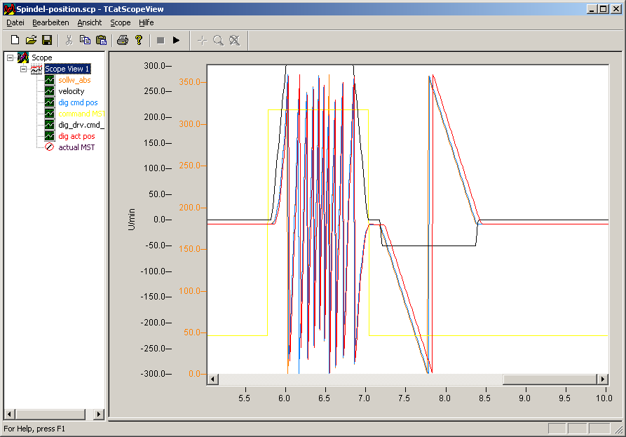

Programming Example
Special case
%spindle-position
(antr.sai_op_mode_change.v_velocity_control_on 1200000
( -> 200 rpm
(antr.sai_op_mode_change.v_position_control_on 600000
( -> 100 rpm
N10 M4  S1000
N20 M19 S.POS=180 M4 S500
M30
Properties 2:
Positioning at 500 rpm despite changeover speed of 200 rpm
