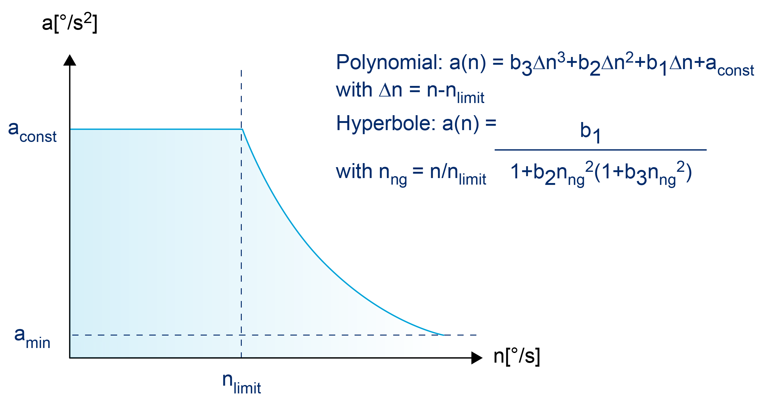

Method 1: Characteristic curve a(n) in polynomial- or hyperbola form
In the range above the limit speed, the current acceleration is optionally specified by a third-order polynomial or by a hyperbola function. In the case of both characteristics, a constant acceleration akonst is used in the range below ngrenz. This corresponds to acceleration at nominal speed. The curves apply to both the speed build-up and slow-down phases.
Interpolation points on the drive curve a(n) are used to determine the coefficients of the curves. 4 or 3 interpolation points are required to determine them.
One interpolation point P1=(n1, (a(n1)) is already defined by the parameter for constant acceleration akonst and the limit speed ngrenz and the user can define the remaining 3 or 2 on the drive characteristic a(n). It is best for the abscissa values to be at a constant distance. The equations to determine the coefficients are listed below.

aconst = 16000 [°/s2] to nlimit = 12000 [°/s]
The following is obtained for the coefficients:
As from nominal speed (nlimit) the characteristic profile is as follows::
