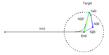

Special case 2: Sequence of multiple short blocks behind the block transition, last block is extremely short
As an exception, the block N40 itself may be shorter than the minimum system-specific length (about 16 μm) required for contouring. In this case, the last end point and the new target point are connected by a linear block. This new linear block N20´ is then used to calculate the contouring curve.
Relevant block length 3:
Single blocks (N20, N30 and N40) are too short but the sum of all blocks exceeds the minimum system-specific block length.

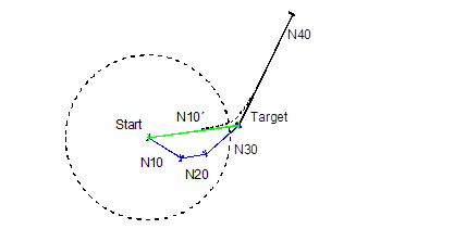

Special case 3: Short blocks before the block transition
If the blocks at the beginning of contouring (before block transition) are already shorter than the minimum system-specific length, the blocks are skipped. The blocks are skipped until the distance between the last valid point and the current target point exceeds the minimum block length. If this is the case, the last end point and the current target point is connected by a linear block N10’. This linear block then is used as the start block for contouring.
Relevant block length 4:
Multiple blocks (N10, N20 and N30) are too short but the sum of all blocks exceeds the minimum system-specific block length.
